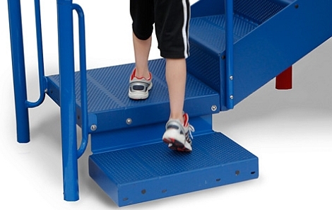

Technology has come a long way in steel coatings. "Powder coating", applied as a "flame spray" or dipped in a fluidized b ed works to melt a thermoplastic and apply it to the steel substrate. The advantage of these coatings is that they are tough, particularly products like Nylon-11 that are used in industrial and utility valves for corrosive service. They can be colored practically any way you would like and for high-production, can be heated in an tunnel oven before being plunged into a fluidized bed of plastic powder. When removed from the bed, the plastic begins to melt and a clean coat of tough plastic applied to the base metal that is only removable by sand blasting (and not easily, at that). One of the little-known advantages of this kind of coating is that it doesn't permit undercutting by rust. A scratch may rust, but it doesn't spread underneath the coat. If you wish, most scratches can be repaired by a propane torch and a salt-shaker full of the correct polymer. Heat, sprinkle, done. It's not always as pretty as a full respray, but it's completely functional.
I had the opportunity to work with the inventor of this process for Dresser Industries some years ago, a Dr. Rene Al, a Belgian (as I recall) import who brought advanced European plastics manufacture to this side of the pond. To say I was gobsmacked by the technology is an understatement, and another friend some years later developed the process into a "flame spray" that passes a fine thermoplastic through the flame of a torch, resulting in a field-applied coating that is almost as durable as that applied in a large manufacturing plant.
Coating the frame and running gear in this manner should resist impact damage from stones thrown up from the wheels, and consequent rust. I would think it would be an excellent preservative for any steel surface as we found flame-sprayed test coupons to be completely undamaged after three years submerged in Galveston Bay. A quick wipe of a gloved hand removed all traces of algae, even barnacles. The steel plate beneath was unaffected. Control samples were all but rusted away.

I think so, Dresser developed it for application to some of their valves that were in severe service applications. My old friend Jim Reimer (Plastic Flamecoat Systems) developed it as a propane flame-sprayed product for applications in process plants, and for coating ship hulls, and oilfield equipment it had to be cost-effective. None of these were cheap, but when you consider you can scoop up the overspray in the paint booth and use it over again (providing your booth is otherwise spotlessly clean, or you just re-grind any wayward chunks to get it back down to the consistency of face powder), it would probably work well as a field-applied option.
For production lines, I would think Dresser Manufacturing's solution would be cheaper as it's suitable for high production rates and there's no waste. Heat the product to the proper temperature (key) and dip it in a vat of powder with air injected at the bottom. Under these conditions, the dry powder behaves like a liquid (I stuck my hand in and sloshed it about). Dipping a component heated to 550°F into the Nylon-11 powder and withdrawing it after about two or three seconds, the red color first appears a flat pink, then as it flows together and cools, becomes bright red (Any color you can imagine is available, just tint as you wish). It really doesn't require any particular skill (unlike flame-spraying), and the process can be largely automated. Nylon is a rather expensive plastic, but EVA (ethylene vinyl acetate) or any one of a dozen cheaper products can be used for greater economy in ordinary service.
The real secret to either process is the fine grind. EVA is pretty cheap, produced by a number of companies like Monsanto in small berry-sized "beads". These are blended with a powdered pigment and "cryogenically" ground by adding liquid nitrogen to the mix as it is conveyed into a hammer mill. The result looks like your color choice of talcum powder. Your only other consumables are electricity, propane, and compressed air. The powder is commercially available nowadays and shouldn't be hard to find.
I would think that dipping the frame in EVA as a rust preventive, and the exposed suspension components into something that might take even more physical abuse, could be as fast or faster than hand-painting. The production line can be maybe 50' in length through the oven and about twice that for cooling after dipping. Of course that depends on linespeed. The economics in today's dollars would have to be investigated, and both companies have been sold a time or two, but a quick Google search reveals the current owners of the technology. Combined with the plastic body panels, coating metal components of the frame and suspension would produce a structure that's impervious to rust, and can still offer a high luster finish. Because it is prone to a slight orange-peel effect, I wouldn't recommend it on flat exterior surfaces, but from a couple feet away, even the flame-sprayed product looks pretty nice.
