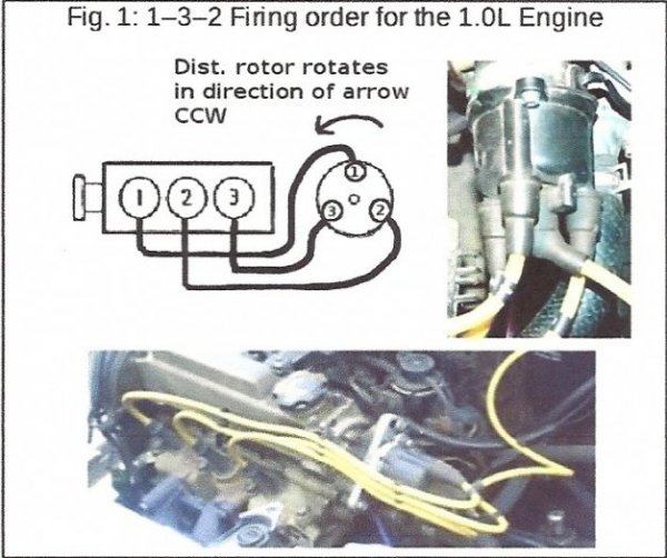

Maybe something like this?
The three cylinders will be firing in consecutive order, either front to back or back to front. Take what ever "firing order" is given in the specs and write it down consecutively several times. In this case it is:
1 3 2 1 3 2 1 3 2 1 3 2
Notice the order of 321 repeatedly. This is the order from back to front. Firing orders are always given starting with number 1 cylinder, but since it is repeated, the actual order the engine is running at, can start at any point.

I think what -Trusting- was trying to reconcile is 3 cylinders with the 4 stroke cycle. Ideally you want a firing piston opposing a compressing one, but with 3 cylinders this doesn't work out, not evenly anyway. What ever the actually cycling is, the G10 in the Swift/Geo-Metro did it for years so it definitely has been worked out.
The best you can do is watch the valves in this video --link--- where they are closed and the piston is at the top, that's the timing of the firing. Timing is much more explicit than talking about the simple firing order.
As you can see, the firing of any one piston is not perfectly opposite from the compression of another. They are solving autocycle dynamic issues in other ways.

First, let me say I didn't explain myself clearly with my question. Apologies! AriLea hit on the problem I was trying to understand... thanks. It looks to me that 4 strokes won't divide into 3 cylinders evenly so you will have uneven firing. I wonder what effect this has on the smoothness of the engine. I'm no engineer so I have to trust those that designed it. It should be good because although the Germans are not known for being great at human relations, they are superb with machines....
