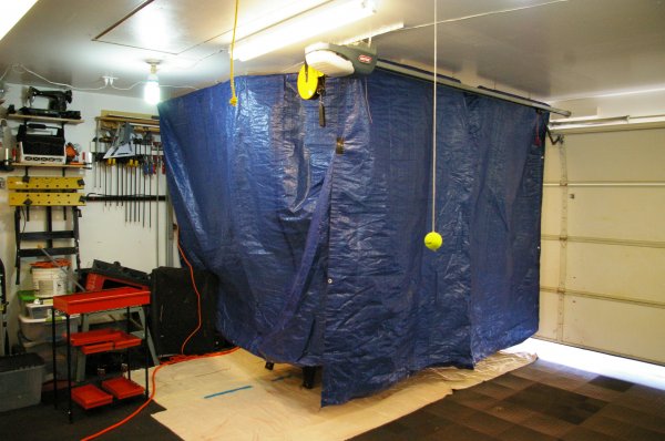

When I was doing painting in my shop I ran into the same problem but came up with a cure. I made a temporary Paint Booth that will go up in about 5 minutes; ventilation is a large box fan blowing out at the bottom of the garage door. The booth is pretty much sealed at the top and has about a 10" gap around the bottom. Fumes will usually hang mid-air or go up; with the fan out the bottom it draws the fumes and blows them outside. I was surprised at how well it works. I sprayed a toolbox the other day in enamel and you couldn't smell any of it in the house (my garage is attached to the house, probably pretty much the same as yours). When I have a lot of machine sanding to do I use the same system and it keeps the dust way down in the shop and the house.
Great idea. I do a lot of sanding for furniture and that would really help. (I don't have a car project to work on at the moment)
