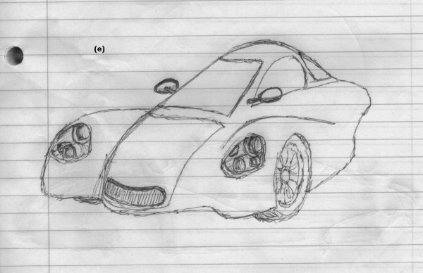

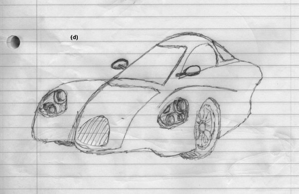

I'm wondering what it would look like if you took just the grill in E & D and flipped them upside down.
I didn't mind E but the "smile" face it created was to wuss for my taste.
D would be ok if the hood was narrower (I said that earlier) or how about just making the grill bigger; something like a Buick grill
e) wasn't actually a smile. It's a curved surface, at that angle it would appear to have one. Even the Buick grill would look that way, at that angle. At ground level (or lower) it would always be a frown. At 12 in it would always be flat. It's a consideration of curved noses.
But upside down, with down curved corners as you suggest, might compensate a bit for the smile.
Same things happen with jets. At some angles in flight viewed from the ground, the wings appear to go forward or even point down. When in fact they are both up and back.

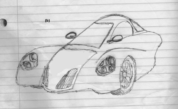

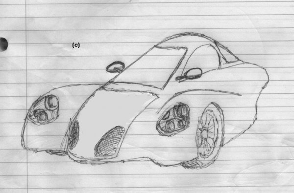

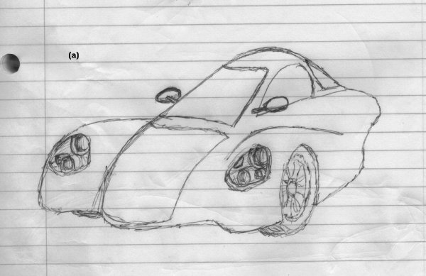

So, I'm curious what people think about various styles for my grill, should it be an ICE drive.
Of these which do you like? (I included the -none- as the EV version)
View attachment 6779 View attachment 6780 View attachment 6781 View attachment 6782 View attachment 6783
I like C. I was thinking of a woven metal wire something like this
In chrome or stainless with a 45 degree rotation from the picture.
Maybe 3/4" or 1" spacing with a 1" half round frame - chrome, stainless, or maybe copper.
