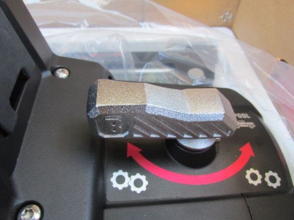

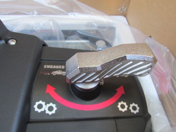

learned something today .... I was looking at the Badland winch and decided to turn the lever (shown below) that throws the winch in and out of gear .... one of the selling points of their Apex line of winches is very smooth lever operation ....I turned the lever throwing it in gear .... when I tried to turn it back, it was locked in place and could not be moved ..
... reread the manual a few times and couldn't find anything .... got on their website and reread everything I could find, no help .... figured I must have gotten a bad one so I drove something over a half hour to take it back .... walked in, paperwork in hand, and found the manager .... she had it brought in from the Trailblazer .... I told her I wanted her to try turning it but she said it wasn't necessary .... I insisted, she tried and couldn't budge it .... she had a replacement brought to the checkout counter and redid all of the paperwork .... I told her that I wanted to try the lever on the replacement before leaving the store .... unpacked the winch to where I could reach the lever .... turned it and just like the one I had just returned, it locked in place ..
.. the store manager was even more shocked than I was .... she said that in the just under 4 years she has worked for Harbor Freight, she has never had a Badland Winch of any type returned due to any problem whatsoever .... they pulled yet another out of stock and before doing anything else, tested the lever .... it locked just the same as the others .... at that point she called two fellows and told them to take the winch in the back and figure out what was going on .... it took them about 30 minutes to do so .... during that time they checked every bit of info they have and found nothing .... finally one of them cut the wire tie that was holding the cable tightly on its spool.... after cutting it, he pulled the cable out an inch or so and BINGO .... the lever released and operated as it should .... talk about relief ..
.. .... lesson learned for them and for me

Hmmm read all instructions and undo all packing material for it to operate correctly. Standard SOP (Standard Operating Procedure)
Or in other words ..................DUHHHH!!!!
7,348
18,161
actually, this was one of the few times I've done just that .... as noted, nowhere and I do mean nowhere do they tell you to cut the wire-tie and loosen the spool to be able to operate the lever

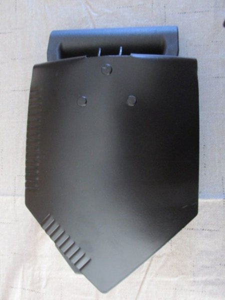

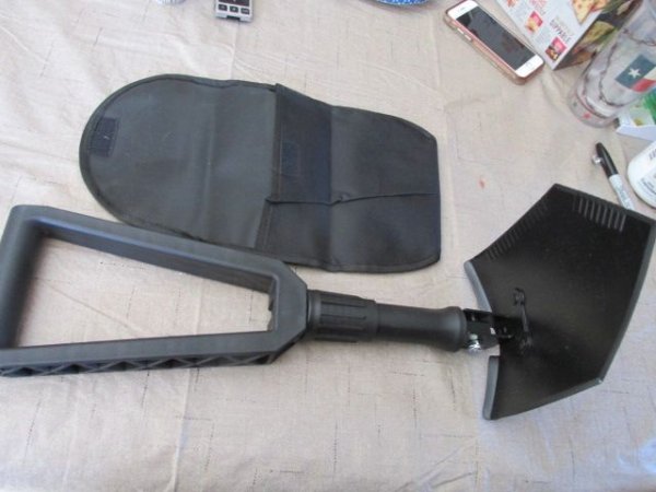

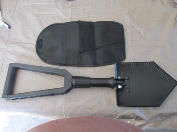

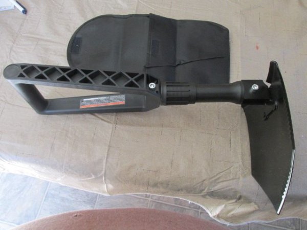

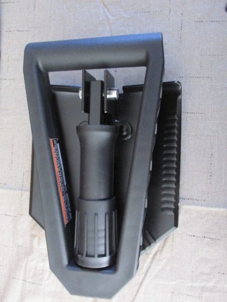

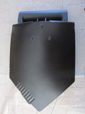

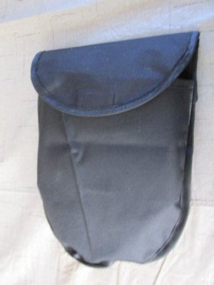

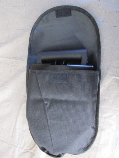

yesterday while wandering around Harbor Freight as they were trying to figure out what was going on with their Apex winches (see 22 above post) I happened to see their Badland Foldable Utility Shovel ===> https://www.harborfreight.com/foldable-utility-shovel-57703.html .... they had it on sale for $11.99 and after handling one, I brought it home .... it has the feel of a heavy duty piece of equipment .... its one of those things that will be packed in our truck with the winch accessories that I sincerely hope will never be needed ...

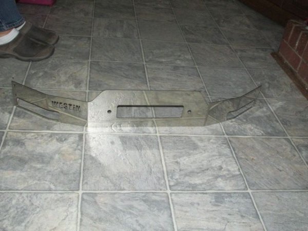

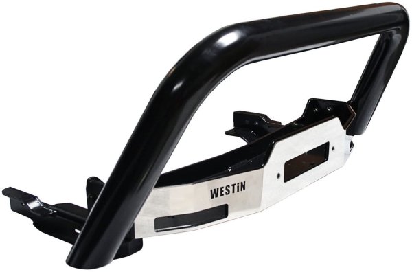

the first of the 5 parts of the Westin Winch Mounting Plate arrived today ... a Mounting plate with a the stainless Faceplate is shown in the the first picture below .... the second shows a picture of our stainless faceplate that arrived today
