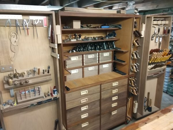

Nope. Too busy with other things. About to make stair spindles for a niece and still have some work to do on the tool cabinet. Here's latest picture with additional drawers and cleaned up a little:

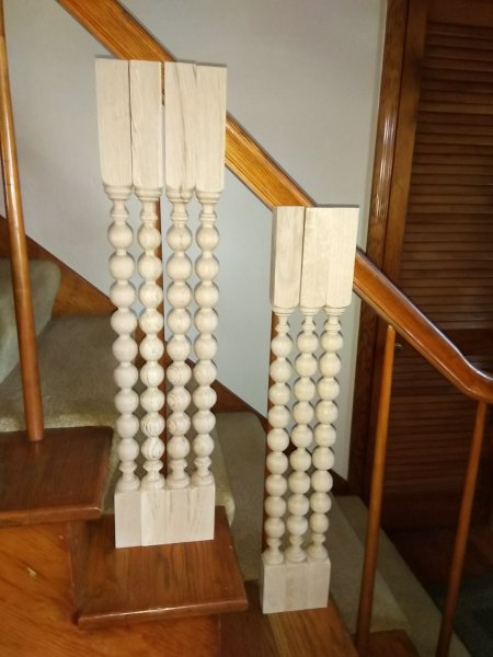

During quarantine last week I worked on some spindles for my niece's 1888 house. She wants to restore the house best she can and some of the spindles were broke or missing. They are turned from red oak. She will cut to length and stain/finish them. She said she feels bad that I am making her "fancy" spindles when mine are so plain. I told her that mine are appropriate for a 1956 house. She want nine, but I'm making her twelve. Doesn't hurt to have spares.

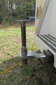

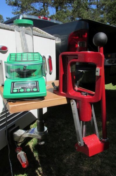

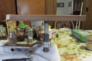

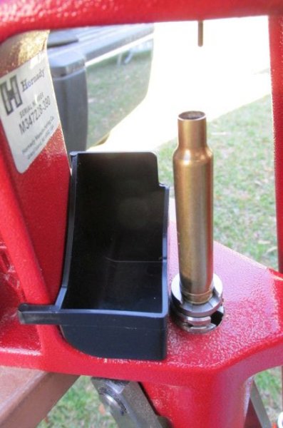

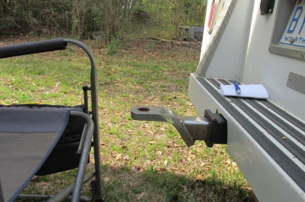

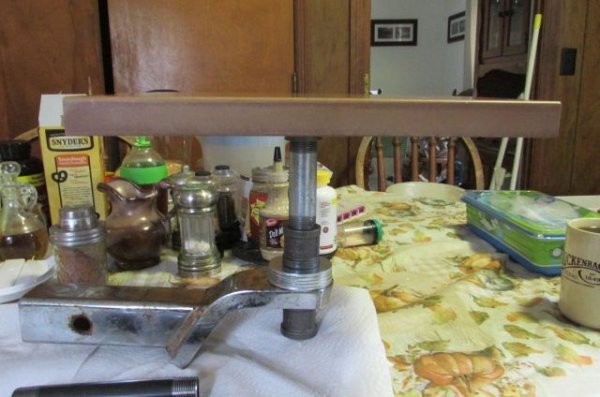

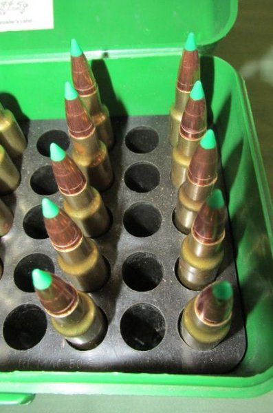

we spend about 6 months a year traveling in our camper .... 3 in Texas and 3 in South Dakota .... we enjoy shooting and load our own ammo .... for years I've toyed with putting together a portable loading kit .... well, I've finally done so it is based on modifying trailer hitch .... the hardest part was reaming out the hole to enlarge it enough to accommodate the 3/4" pipe .... extra counter space will be provided by TV trays .... the reloading station can be quickly and easily disassembled for storage .... the only issue that remains is eliminating the movement from the space between the sides of the hitch and the receiver walls .... a clamp is on order that is designed to eliminate the movement .... the first 10 rounds have been produced
