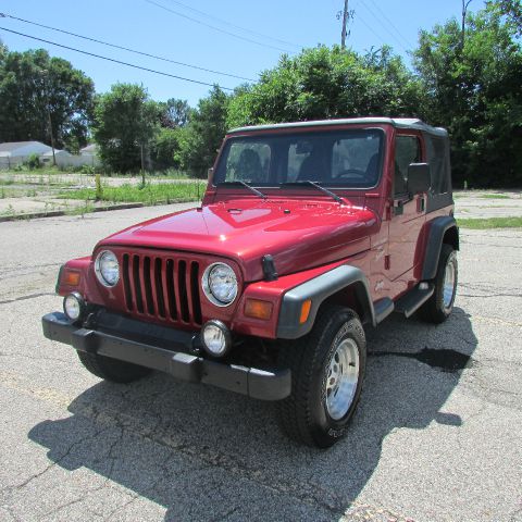

I wonder if some arrangement like this would comply -
Two outboard mounted pod lights might not be exactly pretty, but might be helpful if mounted to the body near the wheel fairings. That would overcome the problem of the beams shaking with the wheel movement. 400 mm is a reasonable distance from the outside extremity of the vehicle. The classic Jeep Wrangler - especially with oversize tires - probably wouldn't meet your trike standards either. I know they're a little confusing at first; headed toward you on a dark night, they're closer than they appear.
Lil4X, those lights are almost identical to the ones fitted to my car. If all else fails, something like that could no doubt be added to an Elio - but wouldn't it be great if the factory could incorporate the European lighting standards from the outset? I'm sure many folks this side of the Atlantic would like to be in the Elio marketplace, too.
