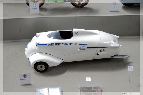

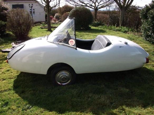

Loved this :thumb:
That just looks fast; I wonder if the performance actually matched?

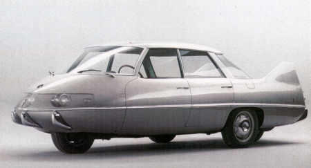

This one: (the one on the right)
For some reason brought to mind a customized CorVan (the Corvair Greenbrier vans that were out in the 60's)
I have no idea why; possibly the front rounded corners. Whatever, it's still very cool.

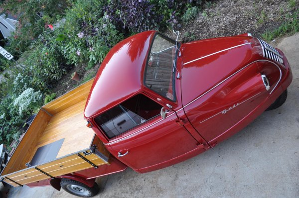

GOLIATH MADE TRIKES FROM 1928 -1961 .
THE DYNAMICS OF A THREE WHEEL TRUCK ARE DIFFERENT FROM A CAR .
YOU WANT THE LOAD SITTING IN BETWEEN TWO WHEELS FOR THE BEST STABILITY
SO WHILE TWO IN FRONT IS BEST FOR A CAR , NOT SO FOR A TRUCK !

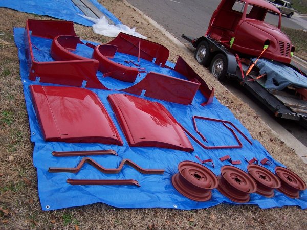

HERE ARE PIECES FOR MY 1959 GOLIATH GOLI TRUCK WHEN I HAULED IT HOME .

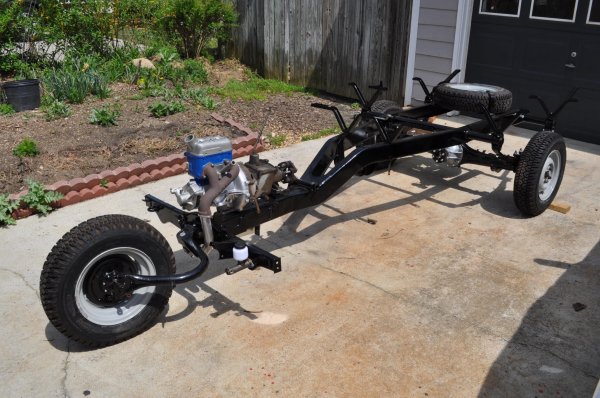

THE ASSEMBLED ROLLING CHASSIS IS BUILT LIKE A TRUCK DESPITE THE TINY TWO STROKE MOTOR .
THE FRONT SUSPENSION ARM IS SOLID CAST IRON & WEIGHS OVER 30 POUNDS !
THE SPRING THAT SUPPORTS IT IS INSIDE THE CHASSIS TUBE .
AND THE TRUCK PUT BACK TOGETHER AGAIN . I STILL NEED TO WIRE IT & PLUMB THE BRAKES .
WOULD YOU BELIEVE THE NC DOT HAS TITLED THIS ONE AS A MOTORCYCLE ?
