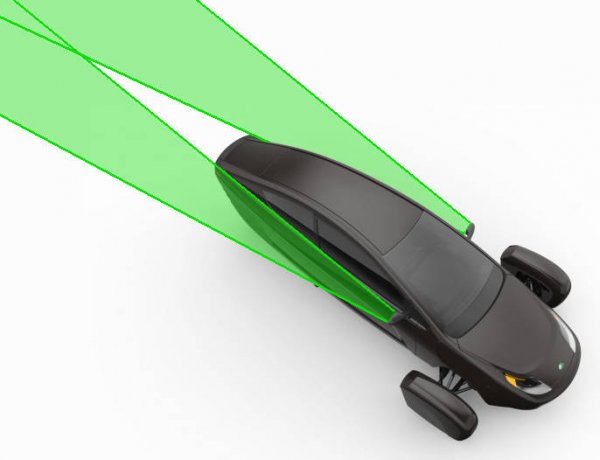

Driving down the road today, I realized my rear view mirrors were both aimed at the lane beside me (for changing lanes) and I use the rear view to see trafic behind me.
The Elio is so narrow that if the mirrors are adjusted the same, I wouldn't see anything behind me, so I will be ordering a rear view camera but nothing else unless the MC type fenders option are cheaper than I can make them. We will see. GB
But, will the rear view camera work only when in reverse?
The mirror viewing angle will probably be wider than when I drew this. I don't think seeing behind will be an issue. As for the sides, the driver is surrounded by glass windows and will have a lot of visibility. I doubt that the backup camera will be able to be used as a rear-view camera while driving forward.

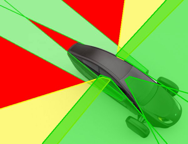

This graphic might be an exaggeration, but it pretty well shows why you shouldn't (at least in a regular car) adjust your mirrors so that you can see the sides of your car.
Here's your visibility:
Anywhere you have overlap is wasted visibility. In front of you, it's free - but visibility behind you is a limited resource.
If you can see it in one mirror, you don't need it in the other. This is more of an issue with regular cars, because having your side mirrors overlap AND have that area covered with the rearview mirror is silly. Why do you need to see the car behind you in 3 mirrors at the same time?
Adjusting mirrors outwards allows you to minimize blind spots which in the above graphic are huge.

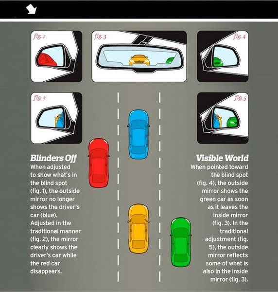

Here's an excellent graphic that describes how mirrors should be aimed. I made the switch myself a few months back and it's much better. Though it takes some getting used to. You actually have to use your mirrors - and the correct ones, since they're not redundant anymore.
7,359
18,165
when towing our camper, the truck's inside mirror is useless .... given that the truck's outside mirrors are much larger but the fact remains that they have to be adjusted so as to give maximum viewing area and minimize blind spots .... the same will be true with the outside mirrors of an Elio .... I don't expect the OEM Elio mirrors will be very large so precise adjustment will be important
