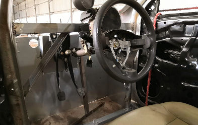

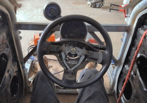

But i have also been getting some hours into the build, the new steering column is the main target at the moment, waiting for the laser shop to cut my new firewall and brackets to mount it all up proper.
Trying to make it highly adjustable to suit a wide range of people sizes.

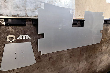

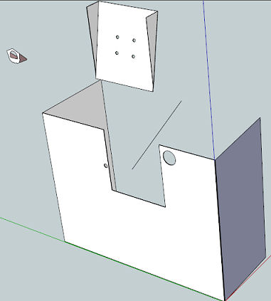

They laser cut my new firewall and steering column brackets today, so I was mucking around with that today.

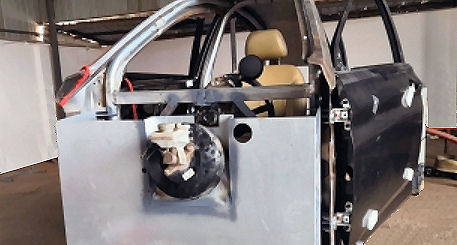

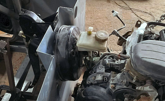

I thought the brake master cylinder fitment might be a serious issue with engine interference and offering a cheaper, lighter version of the car without brakes, which only slow you down anyway, but I think it is less of an issue than I had feared.

As you build your prototype, assuming your goal is a production vehicle in 10+ years, I recommend you implement as many FMVSS motorcycle certification requirements as possible, eliminating the time consuming changes during your certification testing process. Arcimoto’s FUV prototypes and Beta fleet went through a nightmarish 1 1/2 years of private lab certification testing and making the necessary changes needed to certify their production model.
Another thought, does it really need to be power brakes? Your stopping a small vehicle and you shouldn't need that much stopping power.
I think back to a Honda CBX (6 cylinder) and it only had manual brakes for the front and rear, you might be a little overkill.
How much do you think it will weigh when complete? You might be overkill on stopping power.
Just for clarity, boosters don't increase stopping power, that is a function of braking area and friction etc, all a booster does is change the pedal weight. And of course pedal weight itself is also function of master and slave cylinder sizing, and pedal pivot ratio.
The donor car pedal pressure wasn't noticeably heavy or light either way, and since it's components are being used, and that the vehicle's weight won't be dramatically different to the donor, I don't foresee any issue really, other than possibly needing a bias valve to prevent rear wheel lockup.
