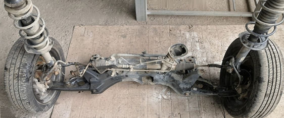

Everyone likes updates, including me of other blogs I follow, but the last week+ has been more about business background stuff, so pictorial updates on the car is actually limited due to meetings and travel.
I did pull out the front end late today and take lots of measurements to see what 'off the shelf parts' I can utilise.
did that front end come off of the Toyota you purchased a while back ..? .. do you have a distance between the front tires in mind for your trike ..?.. if so, how does that distance relate to that of the Yota ..?
Yeah I'm thinking about 1550 to 1600mm/61 to 63" is a good all round compromise, will depend on what CV shafts I can obtain easily.
The Toyota is 1420mm/56".
The Elio I felt was a little too wide at 1700mm/67", starts to lose the advantages of parking, storage and nimbleness in city driving.
The Vanderhall is 1500mm/59"
7,385
18,173
sounds reasonable .... stability while cornering at highway speeds will be interesting .... it should have a low center of gravity which will help with that
