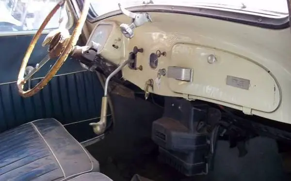

When I was a kid, Dad had a few Citroen Light 15s ..
Also French, the 1950s Renault Fregate had 4 on the tree.
