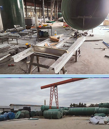

I dropped into the fiberglass company this morning, I wasn't expecting much as Chinese companies are typically slow to get a start on something, but once they do, they are very fast.
They should be finished by week's end, and then needs about 3 days to cure properly, but good news is they are not closing for the holidays, so I should get my first part at the start of next week.
In the meantime I am doing lots in CAD, and it's being productive.
Their main products are large septic tanks, the end caps for the tanks, and sullage tanks are about the same as making my parts.

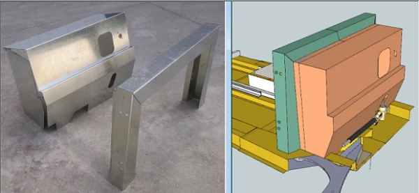

So I got the A pillar 'arch' and the firewall box done today, only 3 pieces needed to make each, simpler, faster, less welding, more accuracy etc. I consider these to be of production design.
Oh, and one big change which I wanted to acomplish, is the steering rack is now on the outside of the firewall, see the CAD drawing, earlier I wasn't sure if I could achieve that until I finalised the floor. It's main feature is it simplifies sealing the firewall box to the outside elements.
Just waiting for the floor now, and that is also a production design, so starting to chip away towards a final, reproducible result.
