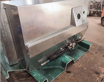

As you see, part of the improved design was to get the steering rack to the outside of the firewall, it simply makes sealing the cabin from the engine bay a lot easier, although carbon monoxide is quite relaxing.
Speaking of carbon monoxide, that floor tunnel in the middle sticking out is where the exhaust will be routed, then down through the left hand floor sill, this was made possible by the staggering of the seats and offsetting the driver to the left some, this was a bonus as exhaust routing can be a real headache.
The amount of floor sticking out will mostly be trimmed back to under the steering rack.

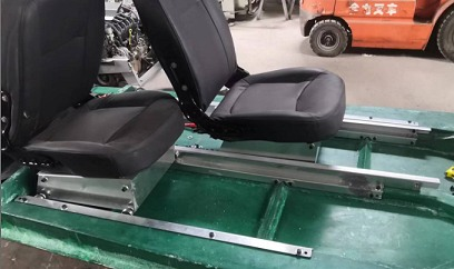

Designed, lasered and folded the lower seat runners.
Some have asked me if the floor is all fiberglass, yes and no, besides the seats rolling along these runners, they are also an integral part of the floor's strength, "bracing" being the correct term. or if you lived in Nepal, you would say "ब्रेसिङ"
These runners are a little short, being the first trial run, and they are fine, I just used what sheet of metal I had in the shop rather than waste money.

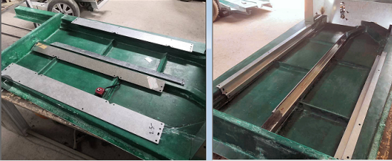

I have been getting a firewall box pattern together, but also did the seat runners on the weekend.
Bit of fiddling around, and some laser'd hole positions need adjustment, but worked out rather well and added a lot of strength to the floor.
Don't mind the ugly cheap black bolts holding them down, not what I will use for the final, as well as the runners being longer.
