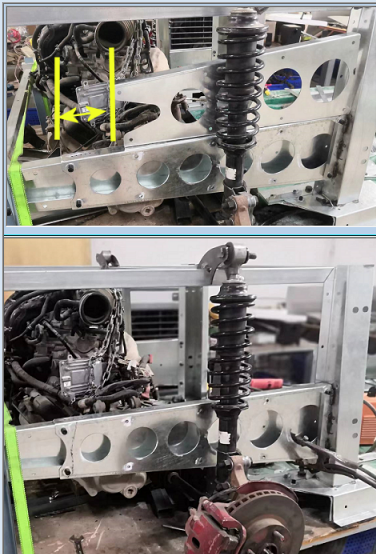

I lengthened the strengthening plate, the distance of the yellow lines, because it didn't quite extend past the engine mounts to my satisfaction, my blunder, I should have measured better.. i.e. as they say, measure 38 times, cut once.

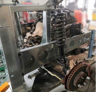

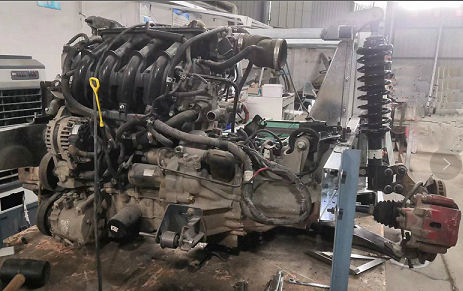

And as you can see, the suspension is basically mounted, including lateral brace from mount to mount that you can't see.
The more I see your progress, the more I like it! Everything is neatly placed. Can't wait for that all important "skeleton run". Go, go, go.:car:

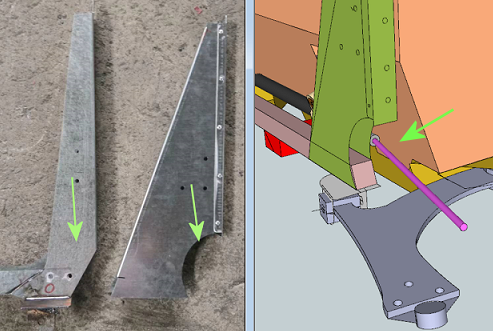

I had to modifiy the lower control arm crossmaber assembley, because the steering tie rods were too close.
You can see the scallop I have taken out, and increased the strength of the assembly some, and to the right, you can see in the CAD drawing where the tie rod routes, and why the scallops.
