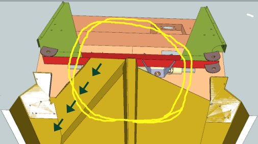

Believe it or not, quiet in the forum means nothing, I have been working my backside off, 3 days and nights in CAD, there is so much optimisation to be done to make things accurate, easy to reproduce, and less parts.
But also, I am extending the front of the floor to meet the steering rack and lower control arm crossmember to be able to accept lateral loads better.
This CAD picture is looking at the front of the floor from underneath. Red is the crossmember, and the arrows is the exhaust tunnel.

Curious about the exhaust system. Will it have access covers? Stainless? All custom bent?
As far as I can see, the exhaust only needs 3 bends from the engine to a straight run from front to rear tucked up in the rh side sill tunnel, then at the rear end, a 'U' turn or 90 degree into the muffler.
"Access"? It's exposed underneath most of it's entire length.
"Stainless"? This is a budget car ....
