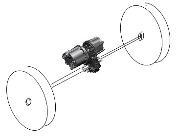

I'd say the Solo issues can be repaired by mods to the car. It wouldn't be too difficult to add $5k in hardware including Front twin motors, extended rear fork, wider AArms at the front. $10k if you contract some of the work. But by then the car has cost $27k.
(add some more battery up front to move the CG, +$4K = $31K or better; fine for a one-off eye catcher)
But it would work hugely better on the freeways at that point. You would in effect be using the Solo as a body and power pack donor.
I don't know if you could apply that to a Sparrow, but that doesn't look as easy to me. (and Yup Fugly for the money)
It does seem just as easy to rip the middle out of some used car to produce a tandem or solo body to host a drive train suitable for freeway speeds, as Mark is doing.

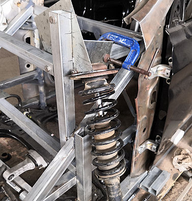

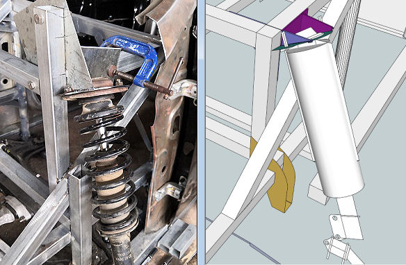

Getting through the front chassis frame and strut mounts a bit at a time.
Don't worry that it's a but ugly and messy at the moment, lots will be trimmed back, some lasered plates rather than tubes, and some removed later.
I have to use some bolts at the moment because I can't know at the moment how the engine and driveline weight will ultimately affect the ground clearance, so may have to move the strut mounts up or down later accordingly.
