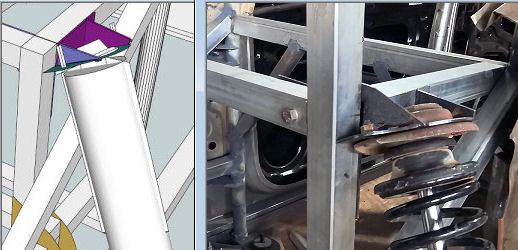

Today was about getting the new strut top mountings together, and you can see it's all much neater looking now up there, as per the CAD drawing ...

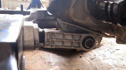

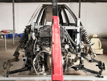

I put the CV shafts in and had to move the engine/gearbox 12mm/0.5" to the right, which was fine as I had already provided for that possibility.

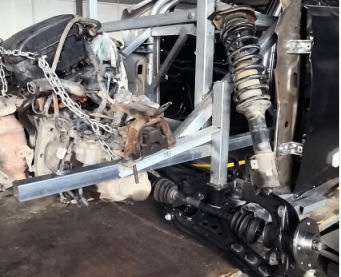

looking at the angle and mounting points of the struts it appears you have a decent shot at shaping the body around them .... sure hope so, they look good and from the video clearly do the job
I can go tighter yet with the suspension package, and may have to, as i think I have too much ground clearance at the moment, and don't want to take the strut tops up any higher (to lower the car).
