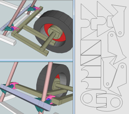

I spent a surprising amount of hours today in CAD getting a bracket/mounting setup for the rear swingarm that I was happy with. Took the file to the laser shop, and their computer was down, so hopefully tomorrow they will be cut.
Note the front of the swingarm is very wide, this is to stop it coming forward into the passenger compartment in the event of a vehicle hitting it up the rear. I will try to design it so the wheel goes under and lifts the BEX up the taking impact energy away.

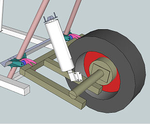

The rear suspension strut should be something like this:

I remain a little concerned about the swing arm.
I want to make it clear to everyone that Ari is 100% correct in his engineering foundations, concerns and recommendations for resolution, and appreciate the input. This is in fact my favorite part about internet forums, eg; having others input for views that I may not have seen, along with new ideas and methods of implementation that I may not have considered.
Note that race and sports motorcycle swingarms have been braced in this pyramid method for decades
From a real world perspective though, based on vehicle type, demographic and real world usage, I am far less concerned about twist/loss of contact area being an issue due to very light loads expected, and had intended to use a camera during testing to view what the rear wheel will be doing under various load conditions to see what additional bracing might be required, if any.
Also note that basic triangulation has yet to be added in the CAD drawing there, and is most certainly happening.

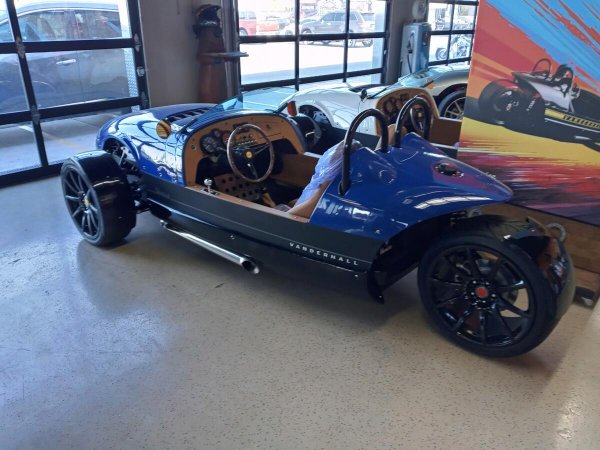

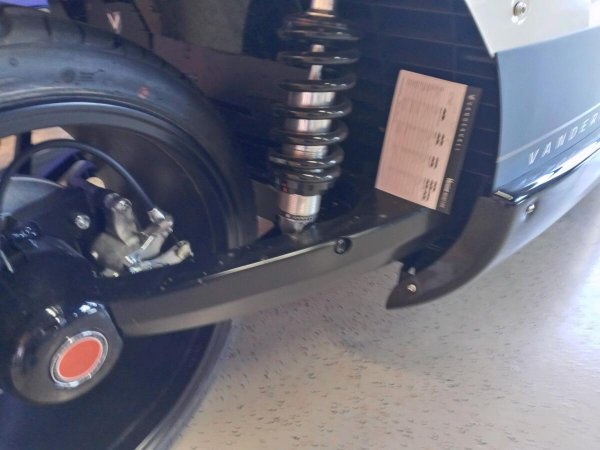

I went by the local dealer in AZ who sells the Vanderhall, see below. This is a very-very light vehicle. 1.4L Engine. Wide and low rims. He also had a white one on hand. Also this gives me more context for the Blackjack Guzzi. They do look like fairly direct equivalents. I took a picture of the rear arm to compare with.
The hood area is wider than the Blackjack, as I expected, since it is a inline engine orientation rather than a sidewinder like the Venice.
(Sorry, slot-car terms from my youth.)
The card I set on top of the arm is 6in long(15cm).
They basically use a large cross-section arm, let's guess it's thin aluminum, casting, then welded halves. Unless they now do rotational molding for metals..(not likely, given how sand acts).
The tread was soft enough I think I could dig it out with my nails. Almost no channel relief for water. Yes it will hydro-plane.

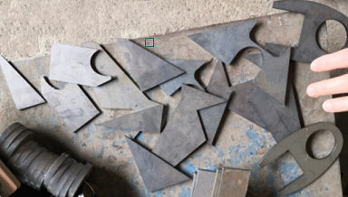

Today I got the laser parts for the rear swingarm mounts,

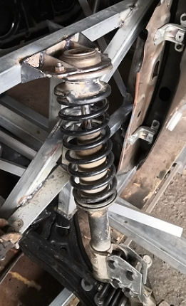

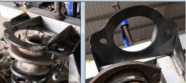

and did the front strut top mounts.
The strut mounts are finished, but able to be moved if need be after I check ride height later.
Bet you don't get change from say $1500 for that, mine would be under $150, using $15 worth of steel ..
