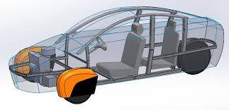

Hi Crimson, I agree that a passenger will change the characteristics of driving, just like it does on a motorcycle when you have a passenger. However, the passenger is not directly above the wheel and suspension system, they are in front of it. So my guess would be that it will have some effect, but not necessarily significant.
Image for reference
Your sketch makes the left side package door look like a viable option. I have now got to look at the current uni-body construction.
Image for reference
Good catch. I am not sure how much the handling would change, merely something to take into consideration along with the rear wheel not tracking behind the front (as mentioned above).
