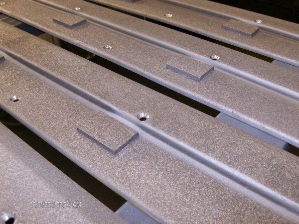

Here is the result of plasma arc transfer on a few of our products. You can see the 'droplets' forming a rough surface on the part, in this case a stainless steel substrate. We do not machine them down, we leave them as-is to create an anti-skid walking surface.

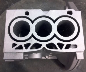

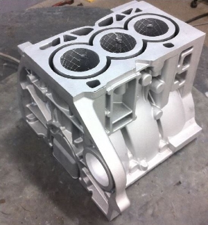

First prototype Elio Motors 3-cylinder block raw casting
A few sample parts are poured and left until solid for the initial casting validation. After this process, the castings are knocked-out and the gating and feeding systems are removed. The castings are dressed with joint lines and any flash is removed. Castings are then heat treated and finally shot blast to clean and improve the appearance.
Step 3: The purpose of this final step of the process is to validate the material integrity and dimensional accuracy of the part. Using a CT scanner, 1 mm image slices are manipulated by a software program into a digital 3D model. This model is then overlaid to IAV’s machine CAD model and reviewed by a metrology engineer. Any deviation from the IAV model is highlighted and reviewed by the project team. This information is then relayed back to IAV via an inspection report.
During the development process, small modifications had to be made for the water jacket and the clamping feature locations for final machining. These were all common items needing detail during the design for manufacturing process.
What’s Next?
As you can see, the first prototype Elio Motors 3–cylinder block has been cast and is in the process of being shipped to IAV in Northville, MI. The next steps will be to take the raw casting and machine all of the specific Elio features.
Using companies like IAV and Grainger & Worral provide leading word-class design for manufacturing processes and features to ensure prototype parts will perform as designed. Stay tuned for an update on the Elio cylinder head in an upcoming Tech Talk.
First prototype Elio Motors 3-cylinder block raw casting -top view
