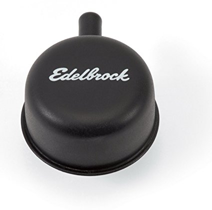

Come on now, you're old enough to remember when they used to put breathers on the valve covers; that were later replaced by EGR valves.
Same thing.
They looked like this from the bottom
And like this from the top
Sure, I also remember rebuilding Dynaflow and Dual Path transmissions in the early'60s but I haven't seen a breather in years.
