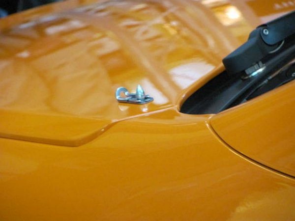

below is a picture I took of one of the hood pins on the P4 when it was in Charlotte last December
