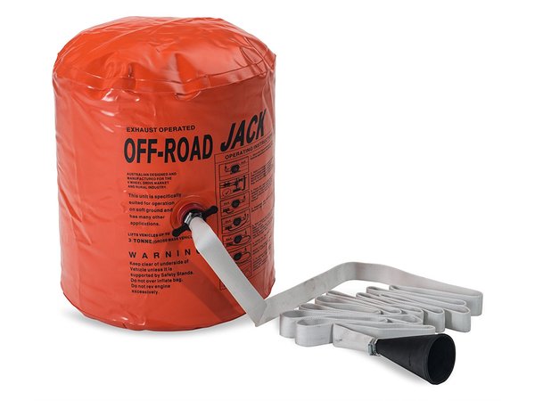

I'm wondering if an air bag style lift might not be a good solution... Use engine exhaust to inflate... Unfortunately, the only ones I can find are for much heavier and bigger cars... This one is for Jeeps... It's rated for 3 tons which is obviously overkill for the Elio... Still you get the idea... Since it collapses it should be easy to find a space somewhere in the car to store it... You'll still need lug wrench and tools to remove protective covers... and a plug kit to make temporary repairs to the tire...

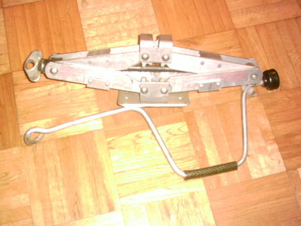

I still have an aluminum jack out of my 71 Datsun 240z, it is VERY light and is only 18 inches long, It could probably fit in it the engine compartment somewhere.

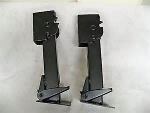

I like it Wheaters! I'd probably go with something like I've got on my Coleman Pop-up. It'll lift the camper right off the ground with ease using a little 16" steel rod for a lever. 1000 lb. capacity per jack. Mount one in each corner for oil changes and such. Light weight and they lock in the up and down positions. About $25 a pair.
I have installed theses on several of my trailers. They provide a very simple yet very effective solution.
