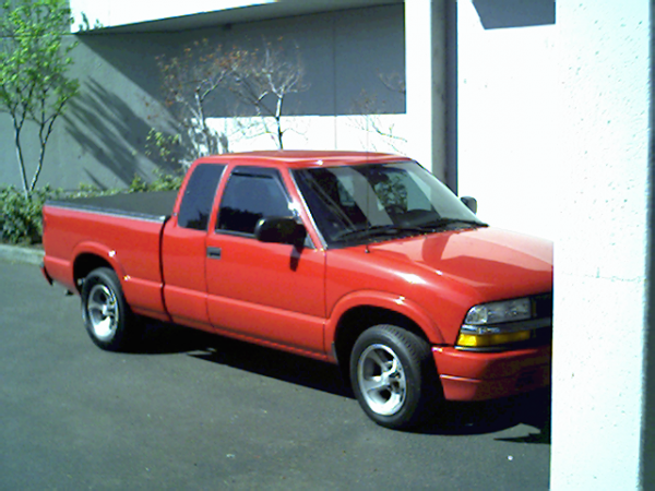

Mine too (Ext. cab)
Those were the stock wheels from Chevy, 8x15 factory rims, and I had different tires on it.

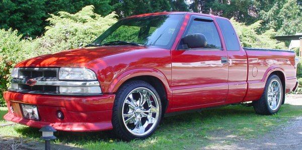

And these are what I ended up with; 9x17 BOSS302 rims.
I had to end up using 1" spacers on all 4 wheels because I couldn't get the right offset.
If I didn't use the spacers, the back tires were up against the springs, and the front tires wouldn't clear the steering links.
The tires in front were 225R40x17 the back's were 285R45x17
Weight was about the same (within a pound or 2 of old to new wheels) it handled fantastic wet or dry.
But it rode like a brick. 40 series have no sidewall "give", the 45's weren't much better.
So that's the trade off, better handling, but really rough ride.
<Oh yeah, I lowered it 3" too>

Looks pretty good. I'm normally not a big fan of lowered trucks but that's probably because it is always over-done. Yours looks good. Me likey.

I did it different then most people; they use air bags, I used dropped spindles, and re-arced springs. So it kept the real "rideability" of the stock truck, just lower. As mentioned, the brick part of the ride came from the tires not having any sidewall give. And for some reason I went through shocks every 30,000 to 40,000 miles; I could tell in the steering; something would just feel wrong, and it would pull to one side or the other like it had low air pressure in the tire. I actually stopped a couple of times to check to see if I had a flat.
When I was reading up on the tires and rims, a lot of people reported cracking a rim if they hit a pothole; I never ran into that problem, but I was also very careful if I saw a pothole (not too common in the PNW) Can you imagine doing that if you had the CF rims? Hit a pothole, and watch $6K go out the window with it. This is where a can of Fix-a-flat wouldn't help; it may seal a leak, but it won't fill in a missing part of the rim.
That is a good looking truck!
Thanks; but I ended up selling it about 5 years ago for a loss. I spun 2 main bearings after 140K and I didn't want to spend the money to go through a motor replacement or upgrade. So I sold it "as-is" for $3,200, blown motor and all.

NICE! My Sonoma was that same red with the same stock wheels. I did the same 3" drop, except spindles & blocks. 16" wheels gave me a bit firmer ride and, yes, it handled great! I bought it with 38K mi. and a "rebuilt title" and strange "knock" in the engine...didn't hear that during my test drive :doh:. My Mechanic friend said to "drive it till you can't stand the noise''. I changed to full synthetic and finally blew a head gasket at 232K miles. I was ready to drop in a 400hp 327 with a Corvette T-56, 6-speed when the Economy "tanked" in '07. I loved that truck!

Looks like very low profile tires. Good for handling.
