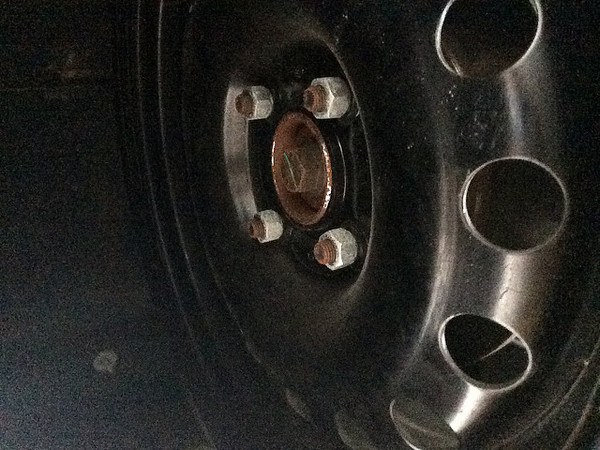

A 5x4.75 hub is WAY overkill for a car this light as much as I'd like the wheel options.(already have a few sets that would work actually) In Nashville the P4's hub was either a 4x100 or 4x108(didn't have anything but a plastic ruler to measure with b/c my micrometer was at home on the workbench.
Anyway here's a pic of the P4's rear lug nuts.

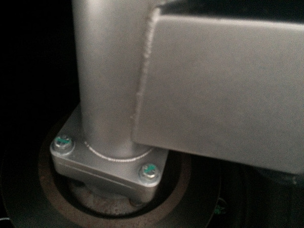

And where the hub assembly mounts
Going any larger with the hub would also likely mean, an extra stud and lug nut, a larger rotor, larger than necessary bearings, as well as all the associated unsprung weight.

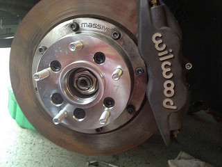

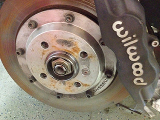

That said, having 4x100 or 4x108 hubs is fine with me. There are some great adaptors on the market these days for adapting overlapping lug patterns. I actually run one of my 5x120 sets of wheels on a 4x100 car on the track b/c 5x120 wheels are easier to find in wide widths.
You are right about 5 x 4.75 being over kill,, just mentioned it because I am really a chevy guy and have lots of gm wheels, not so many 4 lug,,actually do have 2 4x108mm mags..
