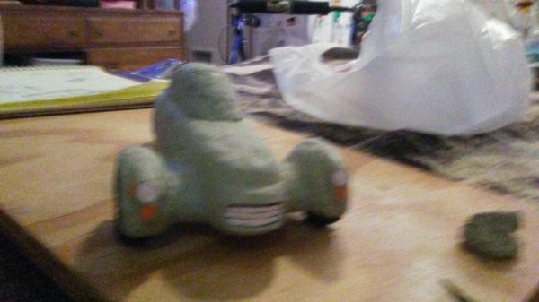

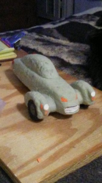

Do you like this first design?
    32
lol, yes it has a mean grit your teeth look. Need to play with that a bit, clay is good for that.
It's always a debate on if a smile or or other treatment is more attractive. I simply added the grill in an old style and it ended up completing a face as it did.
So take a photo for reference and try some changes.
What is best usually is a look that is somewhat indeterminate so the beholder can see what they want to see. Impressionism ya know.

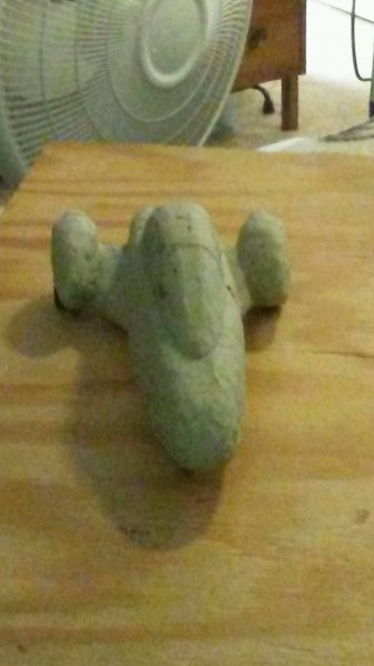

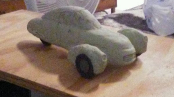

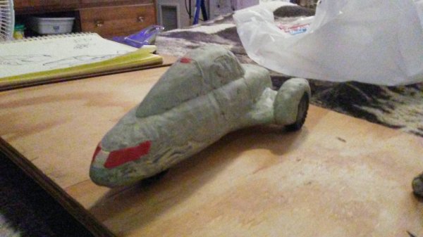

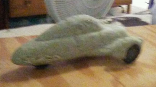

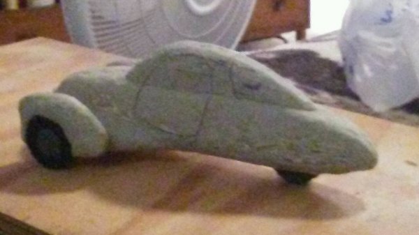

I'm always playing with the ideas. ... variations on variation. This one is a single seater inspired by the 50's. Well maybe a seat and one-half at best... This is a very small vehicle.
Just couldn't leave this thread to die I guess. Before I wire this one in 3d solid modeling, just wanted a verification in clay.
View attachment 12148 View attachment 12151 View attachment 12152 View attachment 12153 View attachment 12154 View attachment 12155 View attachment 12156

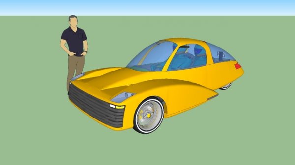

OK, only 9 months later! I had just a little time recently and I 'wired it up' in 3d, and of course uploaded it to the sketch-up 3dwarehouse.
(see below). It occurred to me this was a old-new blend with the mid-post WWII styles, so it was just perfect as a comic book ride.
So I called it the Captain-America Solo Scout Spider in the catalog. Download here if you like. Or just roll it about in 3d in your browser.

I can only guess based on comparisons to known tests. My Taddy got a .20 in real tunnel tests. It was a very slippery form but had exposed AArms, aero-profiled(adding some 'd') and top wing headlight(+d), and enclosed wheels (-d).
This Solo has a sharp tail(-d) but some corner shapes at the fenders and open wheels(+d) but at least the AArms are covered(-d). The Atlantric has open wheels(+) plus not a sharp butt(+). Again suspension is covered. And too the Taddy tunnel model didn't have some open holes and things that the real car would for suspension bits etc. (+d) All three have some limited underbelly exposure but only at the suspension arms, so about equal on that. The Taddy and Atlantric have low noses(-d), the solo a taller profiled front nose(+d).
Total guess here,
Taddy's real cd is likely around .21, but the full drag is very low due to a small profile. The Solo maybe around .205 and Atlantric around .21. The Solo Scout and Atlantric are just a little bigger profiles, with total aero-drag maybe 10%-20% higher than the Taddy.
The weight is the real divergence in the three. Taddy at about 450lbs, Atlantric at about 1100lbs(ICE drive), and this Solo could break under 1000lbs.(230kg, 555kg, 505kg,)
Compared to the California Commuter Car(157mpg@55mph), Taddy should have gotten 155-175mpg(@55mph). Compared to other test vehicles, Atlantric should get 120-135mpg, and The solo should get 125-140mpg. Again all total guessing compared to cars in competition, but in real street/driving conditions (no super milling tactics). I'll quad-tripple down here, all total guessing by real world comparisons, and the expectation of well engineered drive trains.
As for the Elio, I'd expect a competition tuned Elio (all stock) would get between 85 and 100mpg @55 in those same testing conditions.
PS, closing the wheel-wells can add between 5% and 10% to your normal MPG, and between 5% to 15% in these light weight 'full body' vehicles.
