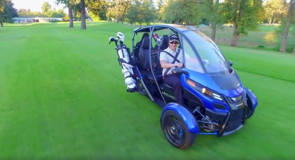

The ear to ear grin on the test driver's face indicates she is having fun just sitting in the Blue FUV! I don't know about you, but If I had $$40 to $80K to spend on an electric vehicle, I'd spend $12K on the Arcimoto FUV to supplement my primary vehicle. :)
