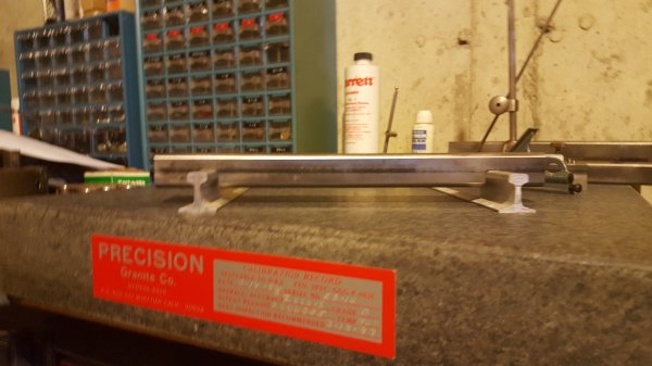

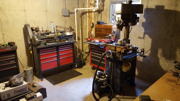

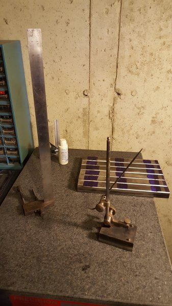

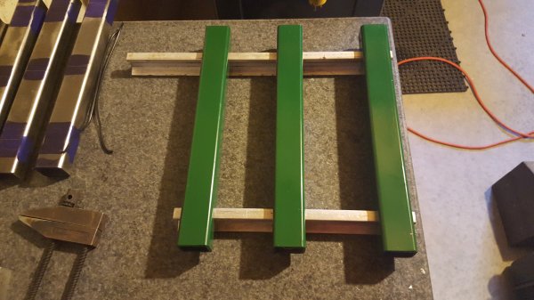

Since retirement, I've been straightening out the basement shop and actually having at a couple of projects. I have a friend in Texas who is building a 7 1/2" gauge garden railway. He needs gauges for building track that will hold the extruded aluminum rails at the right distance while they are fastened to the ties. Straight track is set at 7 5/8" and curves at 7 3/4". Here's a few shots of the shop and the straight track gauges in process a few days ago.

They're a close fit, so it's easier to roll them off and move them. The rail head is .490", so I was aiming for a .004" clearance. Randy uses a fixture to locate the ties (treated 2 x 4); I'm not sure of his assembly method. The "spikes" are washer head stainless sheet metal screws.

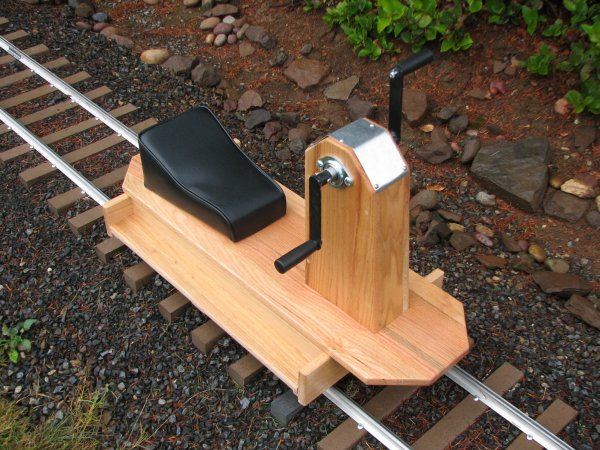

He has a few panels of straight track made up, and one of these for the grandkids. IIRC, he also has a locomotive chassis with a Honda engine and a hydrostatic transmission, and I know he's built two or three flatcars as well. I haven't been down since he started this.:cool:Rail_Pup_Silver_img_3.JPG
