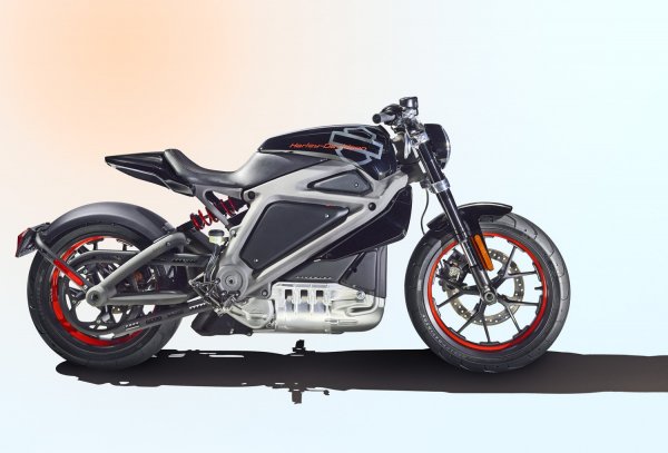

Sure they will. Once they get the high tech playing card in the sppkes perfected, so it still sounds like a '37 John Deere.
I heard an old Harley Biker say it sounded good! I can't use his actual quote! LOL This media statement:

I don't see harley as doing anything as truly original as the Elio. It's not in their corporate genes. LOL Same for Polaris slingshot. The slingshot is nothing more than a $20k up sized hotwheel tricycle. LOL They have not even finished their web site. LOL
