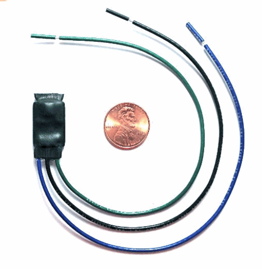

Hmmm... could you clarify what "Video in Motion" might be for me, please? Is that software?

Video in Motion; almost everywhere it is illegal to have video playing within site of the driver when the car is in motion (distracted driver); so they have an interlock system that won't allow video to be played unless the parking brake is on. Video in Motion bypasses that interlock system and allows the unit to play video without the parking brake on. It's a chip with 3 wires.
The camera on when you put it in reverse is easy; you tap the power wire from the camera into the + side of your backup lights; lights go on, power goes to camera, Ding, camera on.
The side with turn signal is controlled by the BCM in the car. Just like the ECM = Engine Control Module; the cars today have a BCM = Body Control Module and it controls driving "features"; in other words a computer that controls all the creature comforts and Foo Foo toys in a car.
Since I don't know of any systems that tag into the BCM, you would have to be really creative to build an aftermarket system that copies your buddy's car.
