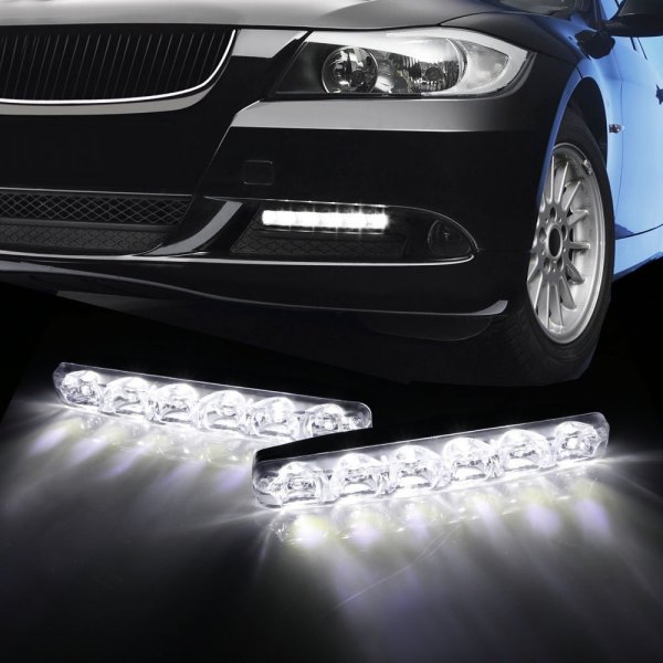

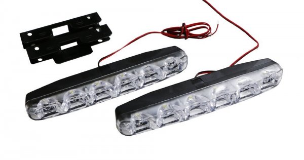

Never thought of the idea of attaching a light strip to the suspension, but I really like that idea. I would attach it to the lower brace and run it horizontal along it. It would provide a little more idea to oncoming vehicles the "width" of my Elio, plus could look cool and act like small fog lights.
(Images just an example)
