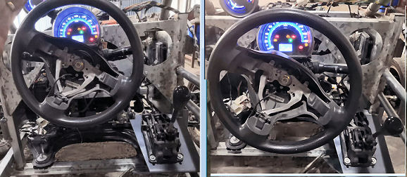

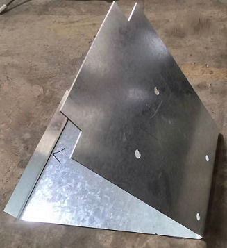

I got back into the factory this afternoon, drew up a temporary gearchange mounting, took it to the laser shop with a box of ice pops for a bribe (hot today), and 30 minutes later back in my factory folding and fitting it.
The gearchange sits high up next to the steering wheel, bit like some mini vans, and the stock cables are an easy straight'ish run to the gearbox, without kinks, twists, or sharp bends, so the change is light and silky smooth.
Won't know if the position is comfortable until I drive it later this week after I get a seat mounted.

Well the first test drive happened today, accidentally.
.. after welding in the gearchange mount and a few other little things, I started it up while sitting on the side of the frame, pressed the clutch in, put it in first, let the clutch out, fell backwards when it jerked forwards, and there I was laying on my back on the frame with the BEX idling forward without concern, heading straight towards the rear of my forklift.
... and that was when I discovered the brakes are working just fine, after just barely getting my toes to the pedal while on my back
.... I had better mount a seat next me thinks!
