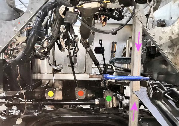

Today worked out well. The new vertical for the gearchange, pink arrows, allowed me to run a tube horizontally to mount the stock throttle pedal to it, was scratching my head how I was going to do it, but got lucky and it was quite easy after all

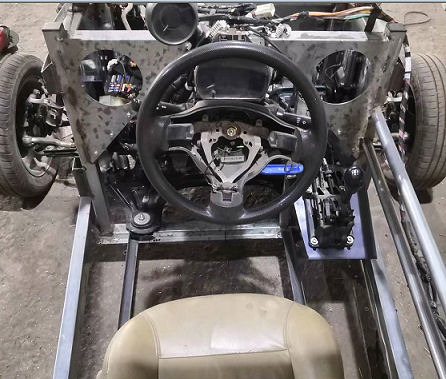

The office is looking rather complete, as soon as the seat is properly mounted, and the throttle cable connected, I might be able to drive it after an extensive safety check.

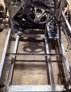

Smooth day today, and some of the good fortune I have been getting with things fitting is uncanny.
Make the seat runner supports, which you can see were nothing more than 2 x longitudinals, with some guides for the wheels on the rear halves, and a latitudinal to mount the front of the seat (se the 2 small holes), that also acts as a chassis crossmember.

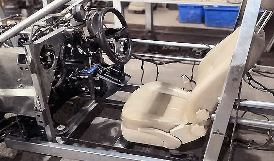

The left mounting offset of the VW Jetta seat is just perfect, like it was designed for the BEX, and the fore/aft movement, and the huge jacking height can suit anyone from 4 foot to 7 foot tall, simply amazing seat for this application.

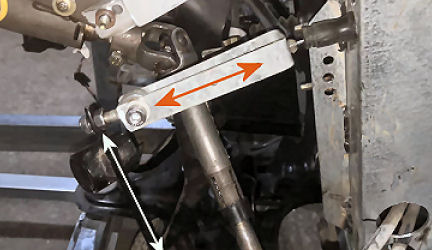

The throttle cable is factory stock, uncanny fortune that the brake master cylinder booster mount was the right angle and right place for the cable to come though to the throttle pedal (white arrow). I merely made an extension to reach it with a small heim joint and metal extension (red arrow).
