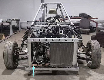

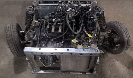

Today bolting things up tight, checking a few things, adding the radiator (have to find a new top hose tomorrow).
I cut the exhaust header pipe and turned it almost 90 degrees pointing out the side (arrow) so it doesn't poison me when I get to drive it.
Besides a top hose and water in the radiator, along with more checking, it's almost ready to do a few test runs up and down the driveway.

Will the offset radiator be centered in the final version or will the body inlet to the radiator be blocked on that side?
For some reason I'm picturing an "after" market funnel for the air intake.
Mark BEX
Feb 2, 2021
1,190
4,745
Australia
Radiator to the side is quite common for transverse engines, where the weight of the engine typically falls more to one side than the other. The battery, washer bottle, fuse boxes etc are also often on the opposite side of the engine to counter the weight.
No reason to block the flow to the exhaust manifold on the right side, the radiator will get enough, and anyway, airflow requires 2 parameters, high pressure to move to low pressure, so what's behind the radiator, or rather what isn't, is critical, and there is a lot of space around the small gearbox behind the radiator.
Oh, and the radiator is actually more centered than it was on the donor car, hence why I need a new, and longer top hose.
You can see the radiator to the left in the video at 2.44 to 2.50

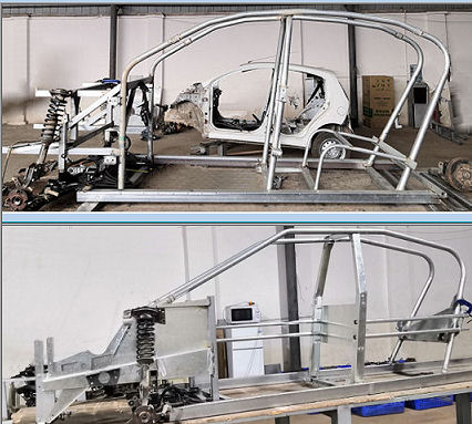

It's already lookin' good naked with all the right proportions....
That was an intentional change in the design in case there is a "naked" market available.
Acrimoto of course help to realise that potential, and good luck to them, but they only have electric version.
You see here the older prototype more rounded shape with 7 bends per main roll over tube (that was always going to be difficult to consistently re-produce), to the later 3 bends only, sharper look ...

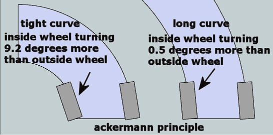

It's been raining for 3 days straight, which foiled my plans to go for some runs out on the street on Thursday, so I am revamping the steering at the moment, mainly reviewing the steering ackermann angles.
For those unfamiliar with ackermann, in general terms, the steering mechanism must turn the inside wheel exponentially more, the more the wheels are turned. I was unhappy with the ackermann amount I had.
So the scrubbing noise of my truck tires turning on the asphalt (slow, sharp turns) is an indication that the Ackermann angles are probably off?
