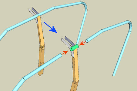

I have revised the rollbar structure to make production easier. The B pillars now have a larger diameter, 4" long piece of tube each end, that the now 4 rollbars simply slip inside of. This allows me a lot of leeway while fitting and aligning the bars, just makes it all easier, while also a tighter fit into the bodywork. Win, win.

The new setup for the B pillars has allowed me to eliminate the "4th bend", which I only added a few days ago (red arrow), which is great, as now the front sections of the roll bars only need the one bend, and simply twist in at the top to tuck them into the bodywork.
Today was spend measuring and designing engine mounts, because they have to fit in with the roll bars on the main engine rails without clashing. You can see the gearbox mount in the picture above, not quite sitting on the rail, it's not a problem, the problem is the engine end.
Engine mount file sent to laser shop, hope to have part tomorrow morning.

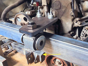

This ugly thing is the RH engine mount. A simple affair at the moment, just a laser cut plate with a rubber isolater bush in a housing with a bolt welded to it, as I wanted it adjustable for the moment.
As often happens, the moment I bolted it on, I immediately saw a better way, one of those "Doh" moments that you just don't see until you make something the wrong way, that shines a light on the right way.
But anyway, that's easy now, the plate will be half the length, and the rubber isolator bush will sit on top of the rail as I now know it will miss the rollbar front leg. By the way, the bush is a Toyota HiLux suspension bush, another easy to get, off the shelf item.
The next drama was, when I made the mount, it showed me where the engine will be positioned, then I noticed the CV driveshaft interfered with the frame at the lower control arm mount, arrow above, luckily I was able to modify that frame area, rather than needing to reconstruct it for now.
