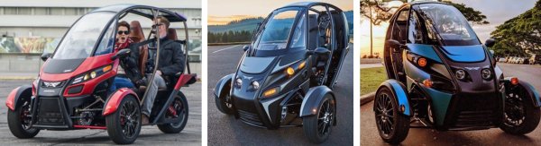

…….and it looks good, but I don’t think Elio was targeting NHTSA motorcycle certification requirements in their prototype builds. I was hoping BEX might be to save a lot of time. Arcimoto missed that step in the process too. They had a heck of a time finding and fitting the right head lamp and had to do an awkward looking turn signal retrofit so it was at the required angle and visible to traffic. Certification was quite the process…….multiple Betas shipped to different private testing lab locations. Still much easier than auto certification with all the required safety standards.

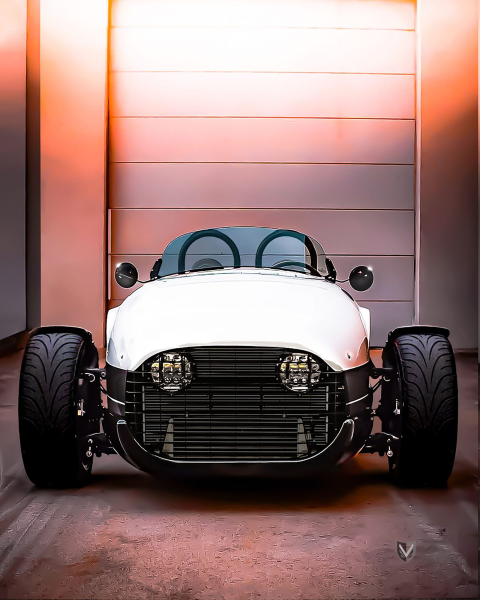

I'm not sure what Vanderhall did to get around the center mounted third light, but they sure don't have one. Perhaps both are always on then the vehicle is running and that's all they needed?

NHTSA Motorcycle Cerification doesn‘t require a single center headlight. The Arcimoto FUV evolved from prototype to certified - left to right: They said it was a “certification from hell” process. Took well over a year.

It may involve distance apart from each other then. Close enough together and toward the center.
3,856
Last I checked, there is a diffinition for motorcycles (and r-trikes) that says some distance from the center, per each state.
For cars, the headlights had to be closer than a distance from the outside wheel/fender and from the front, per each state.
Most Autocycle rules reference to the auto/car rules.
The Vanderhal is a motorcycle/trike in most states. I'm guessing they placed the lights to meet both specifications for most US states.
The Solo meets this by placing lights at both the corners and a set at the center. So it can qualify under autocycle, auto(or car) and motorcycle rules.
Vanderhall Wiki . . . Apparently not in Utah (as of 2016) OR is it?

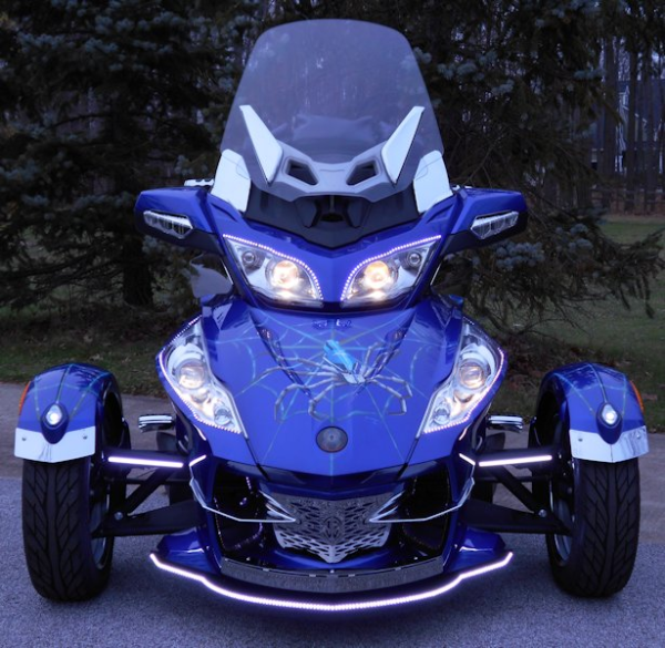

Edited: Notice the Cam-Am-Spyder lights, No lights at center.. Legal in all US states.
They always do have the tiny lights on the fenders.

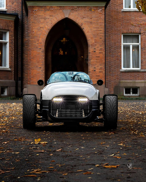

Oddly, I don’t see required turn signals on the Vanderhall?
