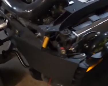

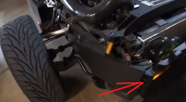

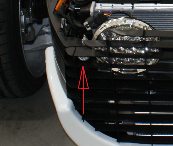

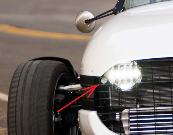

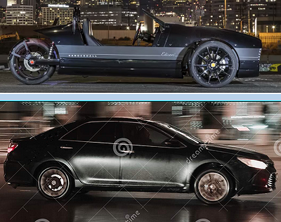

Oddly, I don’t see required turn signals on the Vanderhall?
I believe these (Red arrow) are the stock turn signals. And there are several kit upgrades avilable.

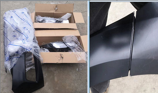

Of the parts I got a few days ago, the front bumper bar was wrong, and it took some effort to find a matching bar to the fenders, but now has arrived, along with headlights.
From this model Accent, not quite the same model as the mock up picture a few days ago, later in fact ..
(It's even a better shape for a 'Superman' logo!)
I'm certainly glad I got the headlights, I was a bit surprised, they are very large, and heavy as well, and need some changes to the front of the frame to clear them, not terribly difficult, just annoying.

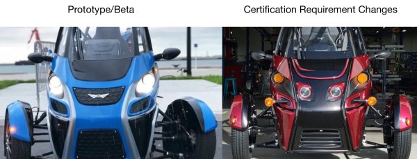

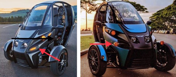

I don't understand how Vanderhall get away with the sunken in headlights and taillights, that appear not to be visable from the sides.
Headlights and taillights being clearly visable from the sides, is a law consistent throughout all Countries and responsible for all the wrap around headlights and taillights you see today.
7,165
14,000
The Certification labs did not let Arcimoto get away with it. They ended up having to change the more stylish body molded turn signals to a stalk mounted fixture so they were visible. Perhaps the Vanderhall isn’t NHTSA certified. I can’t find an official manufacturers VIN Tag, but rather a thin metal tag with a Vehicle number on it. Odd. I didn’t think a vehicle (auto or motorcycle) could register and license without being fully certified.

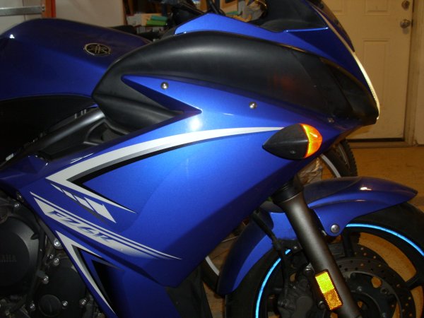

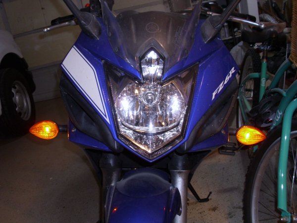

I can't speak to Vanderhall or Acrimoto, but my Yamaha does not have a wrap around headlights or side marker lights. I do know the reflector (on the side is required). I added the reflective wheel tape during one of my "trying to recapture my youth" moments. Otherwise, it is all stock, so it must have been motorcycle certified in its current configuration.
