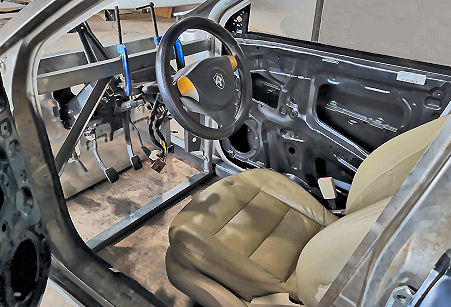

Today I added a crossmember and brace to the front of the roll cage, so I could remove the other brace.
Now I can sit in the car with my legs forward, and start to prepare steering and pedal positioning.

A step further with the steering and pedal arrangement ...

The pedal count is because that's the pedal box I happen to have. it came out of the same car as my mule engine and gearbox, as did the steering column.
Some points:
The foundation of all this is an alternative to the Elio. The Elio was a manual.
Over 80% of interested Parties are 45 and over, they are evenly split between 45 to 55, 55 to 65, 65 and over. There has only been a couple mention they can't drive a manual and usually due to some leg problem, not lack of manual driving skill.
Likely it will be a manual first up, as it's simply the cheapest and easiest to source.
Ideally I would like to source a CVT, it is the most suitable for this lightweight vehicle type. I have options, am investigating them all. It is possible that it will be a CVT, if I find a package at an economical price.
