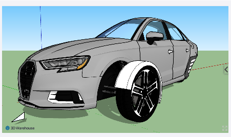

Nice renders AriLea!
I took off a couple of doors to see what it would look like.
I love the opposite doors! Would definitely get some stares when people view the vehicle from the passenger door side! Folks would have to wonder.... how do you get in it to drive? Ha ha!!

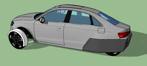

Looking at the various designs for the rear, I couldn't help but wonder if the more open design for the rear wheel would lead to too much water being thrown onto vehicles behind you, therefore requiring a mudflap? Another consideration is with the closed designs if snow accumulation might be a problem.
Also, access to the rear wheel might not be a problem if flat-free tires were used.
I don't see a big issue making the garnish quick to remove.
In theory, 3 wheelers should have less punctures than 4 wheelers, because 90% of punctures are to the rear tires, and that is because the front tire runs over a nail (whatever), and flicks it upright when the rear tire then hits it.
On a 3 wheeler, the rear wheel isn't in line to hit the bouncing nail from the front tire.

Keeping with MB's comments, in/on that skirt you have your lug wrench and jack stored. A spare tire (reduced size) might be inside the skirt, but attached to the car, not the skirt.
And importantly, critical even, for a 3 wheeler, is you are able to keep the center of gravity lower hiding all those ancillaries down low.
The lower the CoG, the more stabilty you have.

as to the shape of the rear tire cover, I do believe it needs to be designed so that the rear tire can be checked without having remove the cover

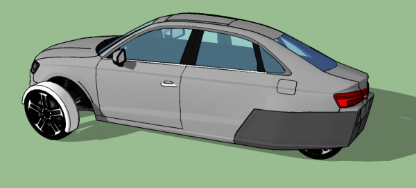

Personally, from the point of view of getting easy access to the rear tire for maintenance etc, I like the more open wheel design, probably the last one.. here is the link to the model where you can roll it around in your browser to see all angles, or download should you wish to.
nice link to the model .... I have no clue how to make it work but its nice none the less ..:typing:
Once the page is loaded, when you hover the mouse over the image, a 3d button shows. Click that. Then for a while the model will download to the browser.
After it loads, and the 3d rendering shows, you click the model (to lock a point) and move the mouse to rotate. Use your mouse wheel to zoom in and out. Clicking again releases the locked point. You can also click/hold and move. Experiment, you will get it.
