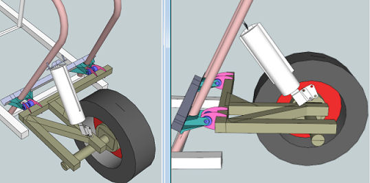

Really nice rendering Arilea......however I really like to see a fat rear tire.....or I guess my question is how wide a tire can you safely use in the rear.....or this will sound really stupid but I'm no expert so...will two thin tires next to each other in a single rear axle can still be called a "3wheeler??

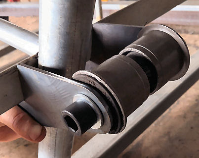

Oh and today I did a bunch of welding on the frame, but i am not satisfied with the rear swingarm bushes, well that's not quite true, the bushes are great, but I need to double up on them to facilitate mounting them better to the chassis.
Mark, thanks for modifying the drawing .... I really do like the way it looks .... can only wish it would be possible to order one right now .... :car: .... do you envision having all 3 tires the same size ..?.. I don't know how much (if any) having the same size tires matters

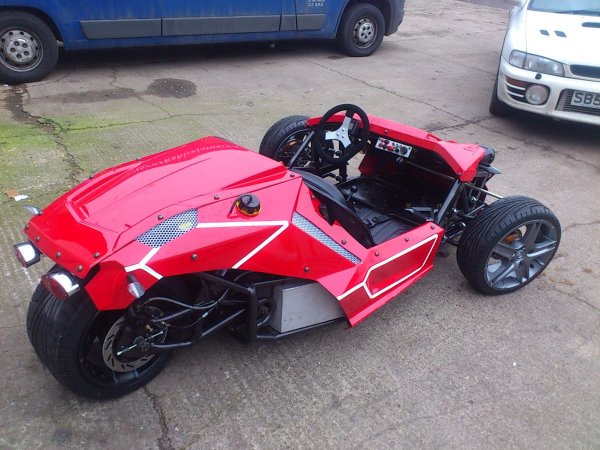

It'll give me a big grin if you decide to use this size rear tire.:becky:
Issue is that tires increase in price exponentially the wider you go. There's no great advantage in this vehicle's intended usage other than looks, but I have considered to leave enough space for people to put a 'widey' (Australian term) on.
My current delay is that when I went to make up the rear swingarm bushes, just looking at it told me that there really wasn't enough bush area, so I decided to double up the bushes each side, as you can see here.
I can use most of the laser cut brackets still, just in a slightly different arrangement, and I'm just waiting for the other 2 bushes I ordered to arrive.
Hope to end up something like this, note no bracing depicted ..

while I like the look of the 'widey' rear tire, its not something I'd pay extra to get .... as noted, having one doesn't offer much of an advantage on a BEX type trike .... its wider footprint might have a bit of a negative impact on mileage and acceleration .... based on the drawing, the strut will most definitely limit space to center a spare .... my preference is for the same size tire to be used both front and rear
