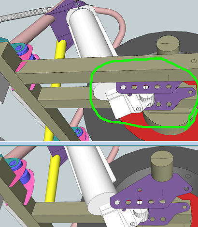

Sometimes you have to go back a step or 2 ...
Looking at how to mount the rear strut to the swingarm proper, I realised I can make the existing joining brackets as the lower strut mounts as well.
So have to cut the axle off the swingarm, laser cut these new purple brackets, and stick it back together!
I have multiple holes for testing later, so I can change the motion ratio to suit (make the suspension softer or harder).
Man.... I LOVE this!!! It's definitely worth a step back to get the adjustability! Bravo!

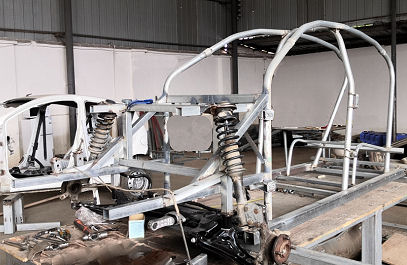

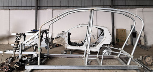

I wasn't trying to sway anyone from the intended 'Elio Alternate', just looking for thoughts is all.
When I look at this, I see an Arcimoto alternate ...
