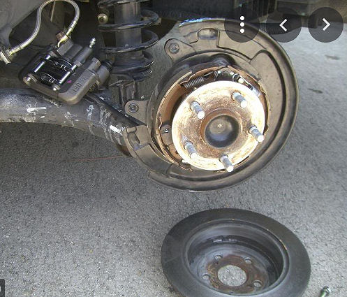

Oh and many rear discs actually have a mini drum brake inside them, because it is far more effective. here is a Toyota Corolla rear disc with inner drum brake for the parking brake.

Very common.
Chevettes were rear drum, most 1970s cars were, large or small.
