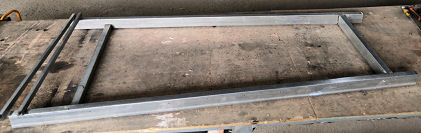

And back to the basics.
At this rate, by tomorrow I should have nothing on the bench at all! :becky:
