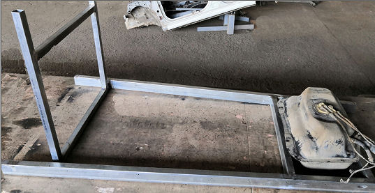

Mapping out the beginnings of a slightly different firewall area to make production easier,
..... and some crossmembers to mount the fuel tank ..

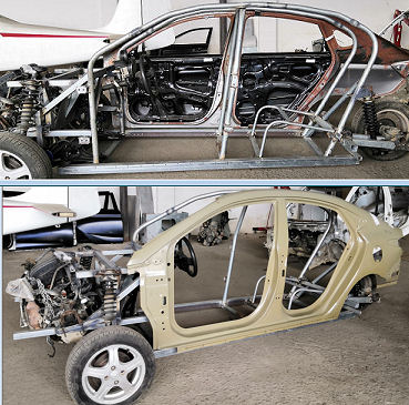

As I was de-structuring the prototype today, I took a picture because it reminded me of those cars cut in half for display at motor shows.
I also sat the new side on the chassis looking at differences and various measurements ....

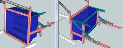

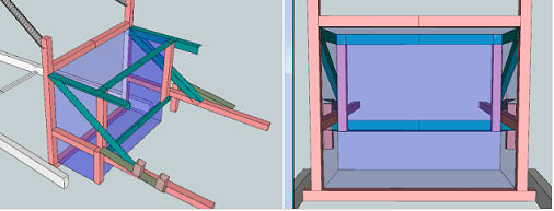

Sometimes I have big wins that don't look so obvious.
The footwell is the area under the dash where your legs and feet go, of course where the pedals are.
I have been on the computer all afternoon, and moved tubes around to figure out how to make the footwell literally a 5 sided box, that can be built on the bench, and simply slid into place from the driver's area.
It's a real win to make life easier. The theoretical "box" is shown in purple here, though in real life it will need some holes, humps and bumps to mount various components, not least the brake master cylinder.
7,390
18,176
very innovative .... do you plan to secure it in place by tack welding, permanent welding, bolting or some other method ..???
I will use bolting as well as liberal amounts of polydimethylsiloxane, being as the 'box' will be fiberglass being attached to steel frame components.
