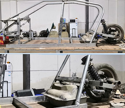

So getting back to the action, back up on the bench and the rear swingarm fitted up, and the fuel tank positioned accordingly.
Bonus is after the move, the exciting new background decor, that includes my microwave and fridge, water cooler and lunchtime seating.
I'm quite fond of the '3 bend' side roll bars, will give an open version a sleek look I think
Yes sir…. That 3 bend roll bars should look sharp on the roadster. Really look forward to seeing the two models…

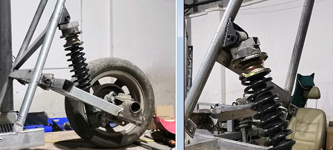

Rear shock top mount today;
The CNC dxf file
The laser cutting ..
The resulting top rear shock mount;
1,695
1,944
The CNC dxf file
