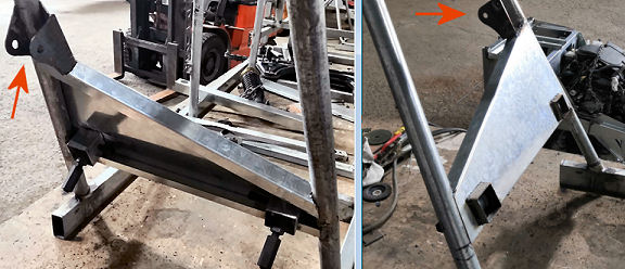

I got around to fitting the rear subframe today, fitted like a treat, looks good, very simple and fast to make.
I was a little surprised that the rear suspension frame mount, red arrow, matched up perfectly to the new subframe, thought I was going to have to make a new one, I'll take that, a win is a win, and allows me to move forward a little each time I have a win :-)

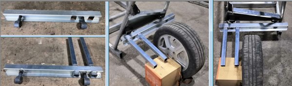

I thought up, designed, lasered and folded the new rear swingarm in a half day today, quite happy how it turned out too.
It's a simple 'tophat' fold, with the tube nuts and tube holes lasered out so it just all fits together in minutes, and gets welded.
Note it is quite wider than the roll bars, intentional to help stop it progressing forward into the cabin in a rear accident.
For those wondering, yes, it will be triangulated later.
