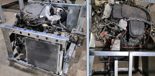

Today's effort was getting the radiator and air conditioning condenser into place, I had to move them forward a little for clearance as they are now moved more to the right than they were in the donor car. I will new a new top radiator hose, but it's a simple 90 degree bend, but the bottom hose is fine.
I had a win with the clutch, as I can use the 'off the shelf' standard clutch cable, there's one less headache. That may sound strange, but remember I have moved the pedals from the left side of the car, to the center, some 500mm/20" to the right, so not everything simply fits again. Luckily the clutch cable was already long and did a 360 degree loop in the donor car, and I have done the same, follow the red dots in the picture :-)

Looking good Mark...
Can't lie, it's the new shoes.
I know it has to make you smile a bit when a donor part – like the clutch cable – fits 100%. Makes us future owners smile as well!
Especially when it's from the same donor car, and not mixing parts too much.
