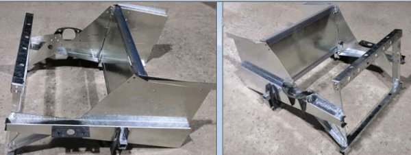

I am most delighted with the results of the front subframe today, I have even named the picture "production front subframe".
It fell together so easily, giving me quiet confidence that only very minor mods will be required from here on in for it. There are more parts to it, but they all fitted up easily and as they should in theory.
This is a big step forward Folks
This looks like it is gonna be half Super Seven!

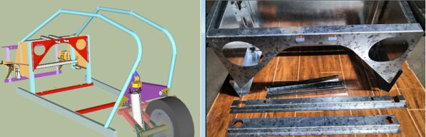

An example of the keys and slots throughout the assembled chassis, to facilitate a more efficient and accurate build ...
you've introduced another production technique for metal that I'd never heard of .... I can understand how it should simplify assembly and I tend to believe it will strengthen the joints :sad:
