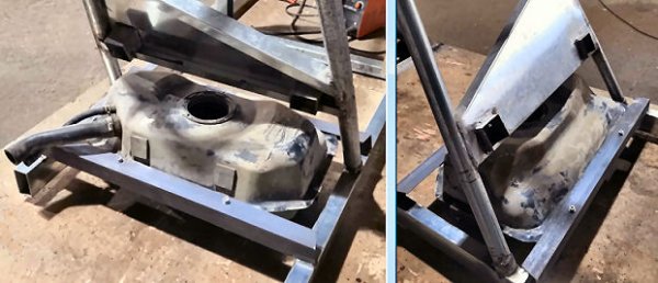

The fuel tank is mounted, but not.
I got a bit complicated with it, took a step back and realised how easy I could make it, cut out what I had made up, grabbed 2 lengths of angle iron, 4 holes and job done.
I will design and laser a more appropriate mounting system, but this is the foundation of it, i.e. KISS.
How big is the fuel tank? One of the things I wish my Honda Fit had was a bigger fuel tank.
